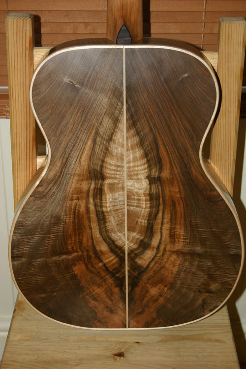

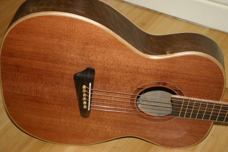

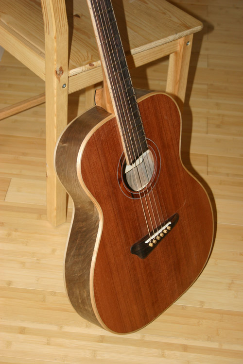

Walnut\Redwood 000
24.9" Scale
Bound in Holly
Cherry Neck
Brazilian Fboard, Bridge, Headstock, and Rosette.

Whoa that's a wild looking piece of walnut! Nice guitar. From your pictures, it looks like a satin finish -- what did you use?

Russell that is a very beautiful guitar. Gorgeous walnut and I love the silking in that redwood top. Very nice indeed.

I like your combination of woods. The holly really makes those dark woods stand out! And, hey, can you see the face in...oh, never mind.

Extraordinary selection of wood choices. This Walnut is superb Brother.

That is really nice. Beautiful color combination. I love that binding. Is there purfling there or is that just really thick binding?

Wow, that's a stunningly beautiful instrument. Love it, details and all.

Beautiful...very colorful. I think that holly frames it all quite nicely...if the binding were dark the whole instrument would have looked and felt darker and heavier...with the holly as a lighter accent it brings out the lighter tones in the Walnut back (which looks spectacular).

WOW! Nice! I got some walnut that looks very similar to that.
You did an excellent job with the color combinations, also. Good eye. I have to ask my wife what colors go good with others.

Man,O Man ! , That Walnut is wild ! A great build Russell .
How do the bass heavy bridges perform compared to traditional ?

Is that the same as my Redwood? If so whoopee! Andy's Claro?
Love the finish, it really lets the wood declare that it's wood.

The finish is a combination of Danish Oil and Shellac, the customer the guitar was for doesn't have his guitars grain filled, and walnut has big pores, and tends to penerate Walnut too much, so I used a polished shellac layer as a seal coat then applied danish oil over the top.
Carlton there is a face

Ron you are right there is a purfling back and front.
Craig the bridge is a bit of an experiment at the customers request, I like it as it brings the bass forward, which on this combo is good, however if it had a european top I suspect it would put it out of balance.
BobC - We have to thank Hank M for the redwood, it is a beautiful piece of wood.
Your top is the same. Its not Claro it is actually English Walnut, from Andy of course.

love the bridge shapeMichaelP38708.3865625

She's a STUNNER Russel. That is a guitar I would say as being built in the "craftsman" style. I really like the mellowness (yea a new word!) of it's appearance. I think I will print it off for insperation!

I am also a fan of thinner body designs. I bet it’s comfortable to play!
What are the dimensions of your sides?
